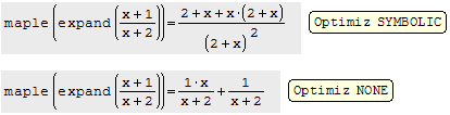

...I have a question, you use commands like "Collect" and "Opt" but they don't appear in "all my functions"; ...
Opt = Symbolic or Opt = None means that you must to right click over an expression, and choose Optimization / Symbolic or None, not a command.
About collect and other expression they aren't from SMath, but from Maple plugin, which is Maple version 6. So, you must to learn something about it. Maplesoft online help could be very extended: Maple help but you can also read some good manuals like "Aprenda Maple 8 como si estuviera en primero" from Universidad de Navarra (you can google it, it's free). Just a notice: Maple V have several differences about how handle strings and some other things, so if you can't find a good short manual about Maple 6 try only up versions.

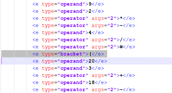

¿Cómo pusiste tantos "iguales booleanos" sin que los paréntesis sean inciertos?
With some hard work you can hack the SMath syntax: From https://en.smath.com/forum/yaf_postsm56111_Some-future-requests.aspx#post56111
HackingEqual.sm (3 КиБ) скачан 157 раз(а).

... Expand options
#18 Опубликовано: 01.09.2021 22:21:44
... matter of preference.
Expand.sm (13 КиБ) скачан 86 раз(а).

555 сообщений из 1333 понравились пользователям.
With some hard work you can hack the SMath syntax.
This is nice. I didn't know it could be done.
Formulas work even after brackets removed.
Not just a cosmetic removal.
