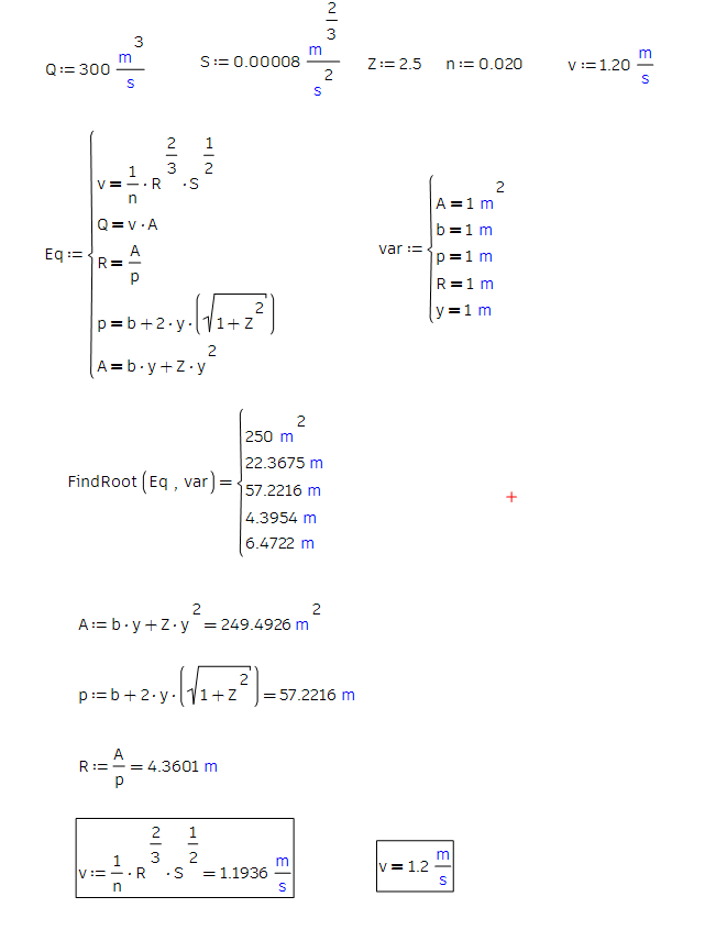

Hi, I want to know what is the method of enhance precision in numerical solution into plugin Nonlinear Solvers.
There is method unless some reference from source.
Some solvers work more accurately then others.
Generally, they will range from 4 decimals to 15 decimals.
Some functions are so involved in numerical error propagation
that you will have to refine the search range ... Goat radius.
Cheers ... Jean.
Precision.sm (20 КиБ) скачан 94 раз(а).
#3 Опубликовано: 09.10.2021 15:34:37
Roman2302
Roman2302
Yes, using a initial values more accurately I have a better precision. Thanks so much
