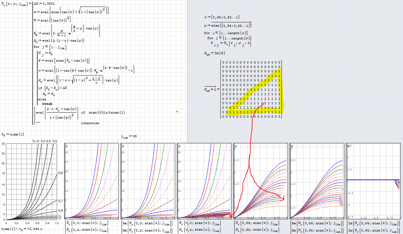

The plots of N.γ(0.9,atan(x)) and N.γ(0.95,atan(x)) has an odd shape when they approach x=1. It turns out there are some complex solutions in this area.
Is there anything to be done about this, to make the graph closer resemble the diagram?
This is a good observation, I did catch it but didn't mention.
Yes the system generates some complex values, can't track it back
in the generating algo. Will have another look.
The atan(,) from numerical libraries does not generate complex.
That's why you had no plot initially, complex blinds the Quick plot.

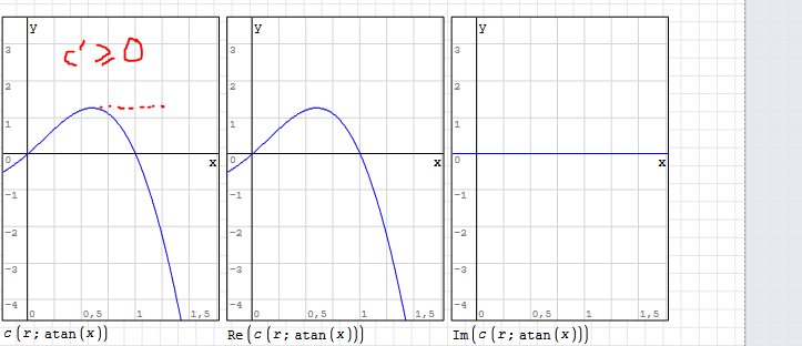

Take a look at this sheet, where every factor of the equation has been ploted separately.
It seems the complex numbers starts with X.c before the iterations start, due to c going negative.
EDIT: It seems in order to produce a plot similar to that of the diagram, dc/dx can not be allowed to be negative. How would I be able to manipulate this?
Cheers.

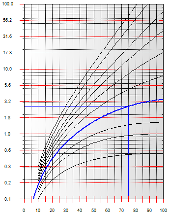

Back at it again, I am now trying to plot these functions in Zedgraph with a log scale.
I've found that "if" within the function is not supported by Zedgraph ("x is not defined") and "cases" breaks the iteration process.
Is there any way to make zedgraph plot my function?

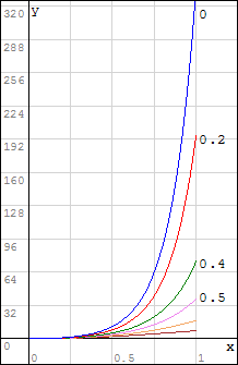

log scale 'y' deteriorates the reality. The project is in two different plots.
Easy to add labels for the part of large deviations, like this demo.
IMHO, much better for publishing the reality. You can label part two as well.

Thanks Jean for your reply, but it doesnt quite solve my problem.
Attached is a sheet showing what I want to achieve, and explaining the troubles I have trying to do that.

You can create an interpolated blue track trace, read Nγ on the plot.
I'm not completely happy of the Y log, however immaterial for application.
