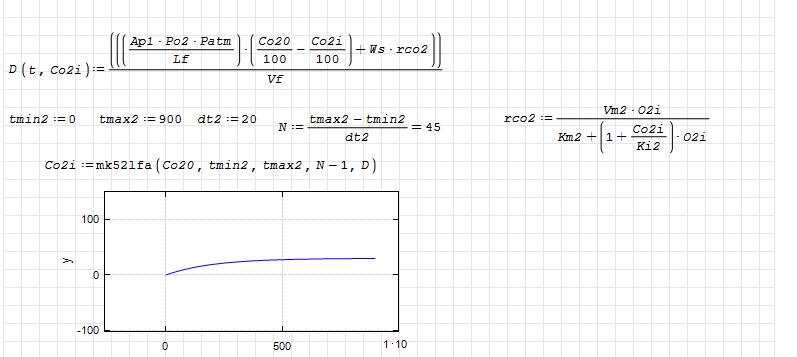

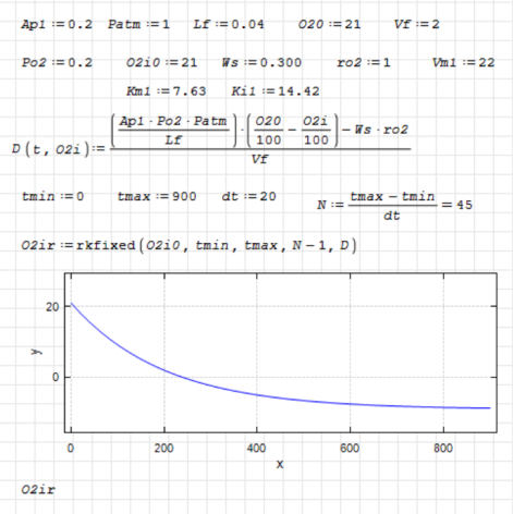

Hello everyone, I have started to use this program from just a couple of days and I have some problems with the model that I'm trying to implement.
So basically I have two ODE with into them some parameters that changing in time...Obviously, nothing work and I would like to have a little bit of help.
Ok, I'm not the best at explaining this, so I attach the file and I hope that someone can give me some good advice to make this thing work!
Prova modello permeabilita.sm (128 КиБ) скачан 58 раз(а).

You need to be more careful about the variables and their order in the document.

Ok, seems that I was able to do some progress here but, obviously, there is something that I think doesn't work
In your opinion this way the value of rco2 change with the new value of Co2i or it remains the initial value that I have set?
Prova modello permeabilita.sm (129 КиБ) скачан 48 раз(а).

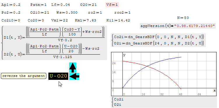

#8 Опубликовано: 23.11.2020 12:18:13
#9 Опубликовано: 23.11.2020 12:26:42

Really thank you for this correction, seems great!
g Ok, definitely I have to study hard and better how to use smath and repay the community.

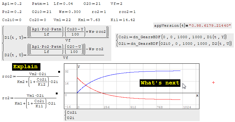

#12 Опубликовано: 23.11.2020 15:31:15
Now I work a little on this thing and we will see what progress I'm able to do.
AbsTol, RelTol is very specific w/o project application(s)
The attached is suggestive of exploring more.
ODE GearsBDF Undocumented.sm (18 КиБ) скачан 52 раз(а).
#13 Опубликовано: 23.11.2020 21:12:46
francesco88
francesco88
1 сообщений из 34 понравились пользователям.
From the web visit, if 9 out of 10 same link are "404",
the originator is negligent, not to say "not trustable"
Paying $ to Elswier ... my ass !
No need for all that jargon, just give what you want to control,
I will close a control loop to optimum degree of accuracy !
Sorry, for sure is for my bad english, I'm missing the meaning.
What I want to obtain is the evolution of the atmospheric concentration and respiration in the packaging.
So something like
That is more or less what uni has done
Veniamo da molto lontano e andiamo molto lontano! Palmiro Togliatti

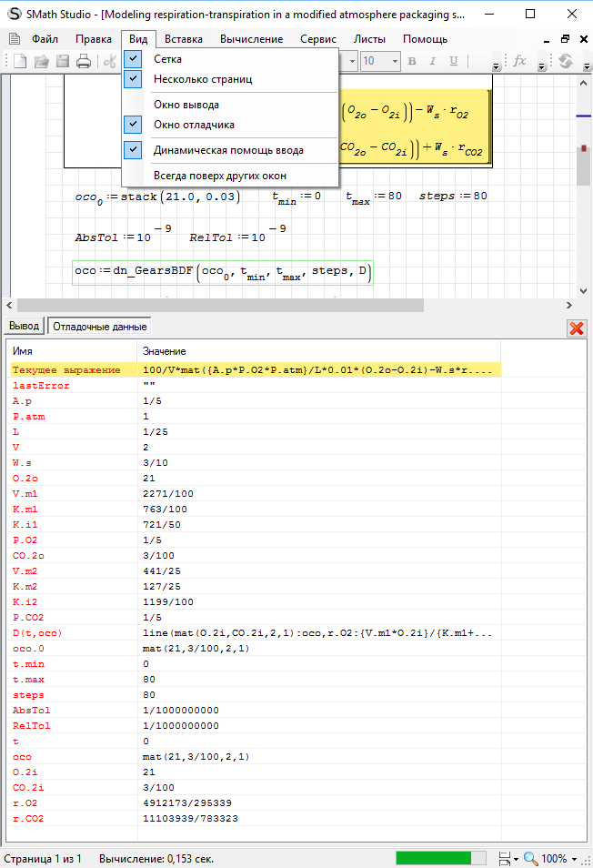

#15 Опубликовано: 23.11.2020 23:55:07
1402 сообщений из 1708 понравились пользователям.
You can set breakpoint on line in D(t,oco) and you will see how values changed.

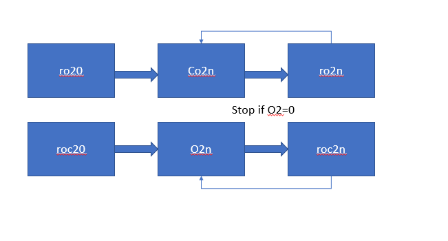

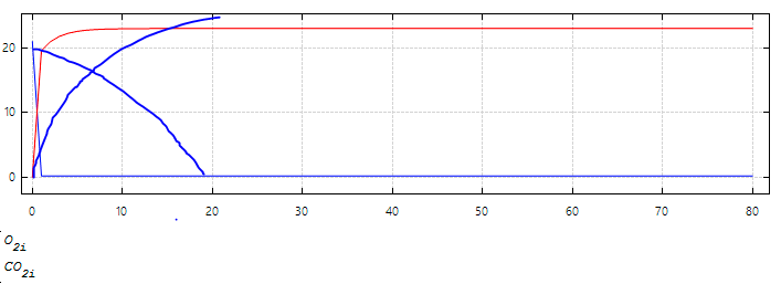

#16 Опубликовано: 24.11.2020 07:24:14
francesco88
francesco88
Yes, I have to study a little bit about this function of smath...to be honest, all the functions!
In general, there is something that doesn't work properly, because the chart describes the depleting and the increment almost linear until the O2 don't reach 0. After that point the CO2 increment start to being described in a "realistic way
I mean, I'm expecting to see something like that (the thick blue lines)

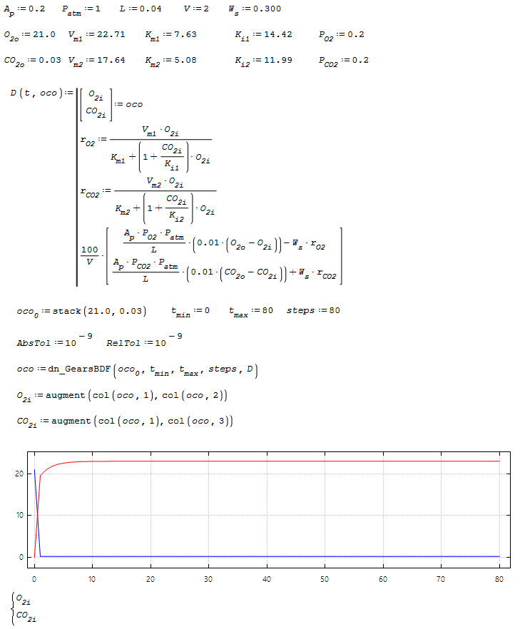

#17 Опубликовано: 24.11.2020 08:03:32
You need to set real values for all variables. It is not entirely clear from the article what values to use. I can't help here, because I'm not familiar with this task.
I have demonstrated how you can solve this problem. Now you just need to correctly describe it in terms of the program. I wish you success.

#19 Опубликовано: 24.11.2020 11:06:59
Like this ??? ... freak parameters at will .
#20 Опубликовано: 24.11.2020 11:36:51
... up to You the expert !
Prova modello permeabilita.sm (129 КиБ) скачан 60 раз(а).
