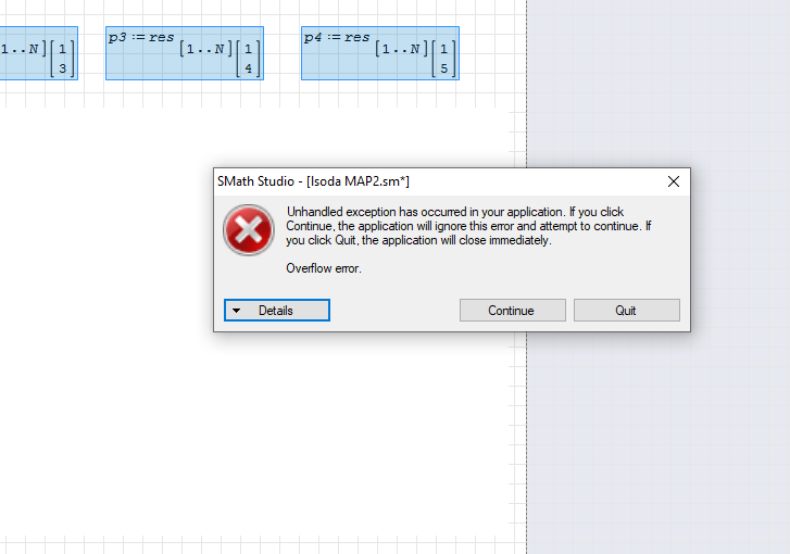

You can report about problem with lsoda plugin here. Please attach an example that reproduces the problem with your message. You also need to specify the version of the program and the version of the plugin.
But as I can see, this is an issue related to visualisation with the X-Y Plot plugin. I wonder what data led to his fall.
Viacheslav, yes I found where the problem was, an error in the variable assignations of the ODE related to the microbial growth that went to -infinite and crashed everything, now I have solved it but in any case, I attach the file in the lsoda plugin page, so you can see it.

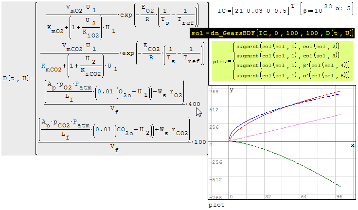

2. DE's system are universal in vector format. Exhaust the 17 native Smath.
Exceptionally, I found only one that did the project [which one now ?]
3. I'm not arguing about ISODA. However, if you can't have it in
normalized format => recycle bin.
4. Your preamble coefficients open in most glorious mess in my SS 6179.
5. Construct the image ... as you hover the vector, you see the internal expansion.
Often, that is damned useful for export.

The problem is in the X-Y Plot plugin. It cannot display the input data because it is outside the normal bounds

You seem to fabricate ... show the vector DE's from source,
so we can exhaust Smath native DE's solvers plus more from the brew.
That 'bdf' vector, is that what you plug in ISODA ? magic plot
w/o data sets, you are @ square 1 [rather square 0].

3. Clean the top part and re-post this document as you manipulate the vector D(t,U)
That freak, unless multiplied by a damned huge number from blue sky has no meaning.

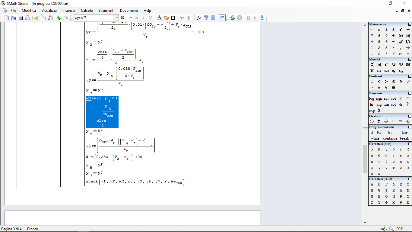

So, after a while, I'm back.
The work is still in progress, but things start to make sense.
I really don't know if my use of the "grammatic" in the system is correct or if I'm only lucky, but the results on paper are reasonable.
The "big" issue now is to make the "if" work properly, but in a way or another I will fix that problem.
I'm exploring different solutions.
As soon I will have the possibility to validate it I will put here the final work.
The model is something like a spherical horse for sure, a lot of simplifications, but I'm facing really a lot of troubles to obtaining a correct connection in the variables.
Anyway, I'm having a lot of fun.
In progress LSODA.sm (60 КиБ) скачан 49 раз(а).
