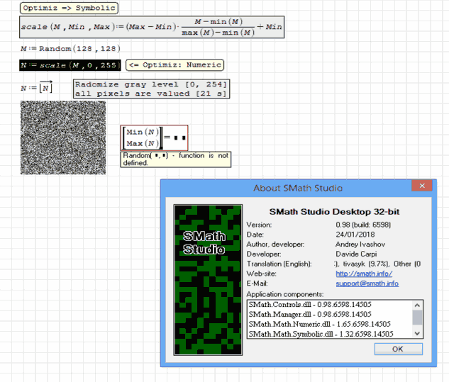

Thank you very much Alyles for your answer, now I have Smath Studio in 32 bits,
but even so I can not follow the example of Jean called "Page1 Randomize Matrix.sm",
it gives me the error "Random () Function is not defined
Carlos

Davide, previously had already checked with the portable
distribution of Martin Kraska and the file runs without
any problem, recognizing the statistical functions.
As the portable distribution is 32 bits, I thought that
the problem was that Smath Studio to 64 bits, did not
recognize the statistical tools plugin

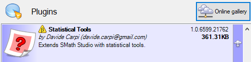

From your screenshot seems that the plgin is recognized (green in loaded plugins) but the functions are not loaded for some reasons. I have recompiled the plugin for the latest SS beta, please try if this works for you (plugin recompiled as beta too).

Hello Davide
The plugin has a very strange behavior.
I deleted the current plugin and loaded the updated, ran the file and executed perfectly.
I closed smath studio and reopened it, ran the file again, and the statistical functions were not recognized again.
Carlos

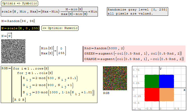

Added: a refreshed version.
Random_5 Matrix [RGB].sm (102 КиБ) скачан 69 раз(а).
