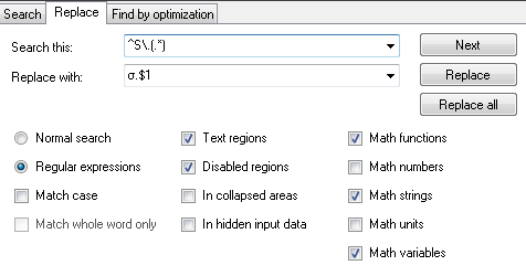

Davide, is there a way / syntax that allows "Text Region Utilities" plugin to substitute some text with a new text containing greek letters?
You can use regular expressions, like this:
The syntax means:
SEARCH anything that starts (^) with (S) and a subscript (\.) and capture anything after it ((.*)) [parethesis are the "capture" group, the period means "any character" and the asterisk "zero or more times"; BTW the subscript symbol is escaped with \ because otherwise it means "any character" )
REPLACE with sigma (σ) a subscript (.) and the first of the captured strings ($1)
This might be simplified or much more complicated depending on the cases (what is available on the worksheet and the patterns)

OK Davide, that's more or less the goal I had in mind, I'll need some more study about the proposed notation but you put me on the right path, thank you.
