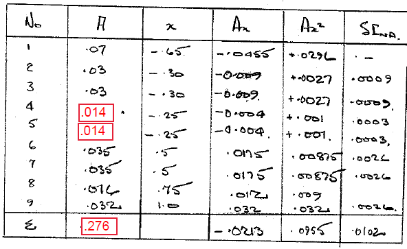

Hi Gurus:
Does Smath has Excel or Spreadsheet region plug in function?
I am trying to make a table to calculate area moment to inertia but dont know how to make it work.
Thanks,
Chris

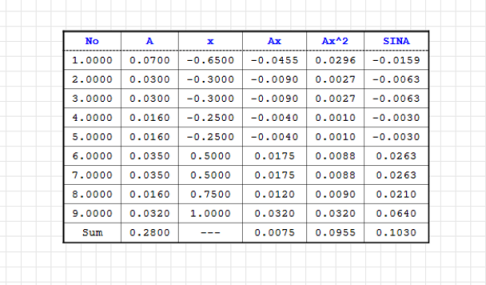

Something like this?
Tabla_Momentos.sm (57 КиБ) скачан 85 раз(а).
Carlos
Carlos
Exactly what I was looking for! Thank you so much! This function is going to be really useful for me.

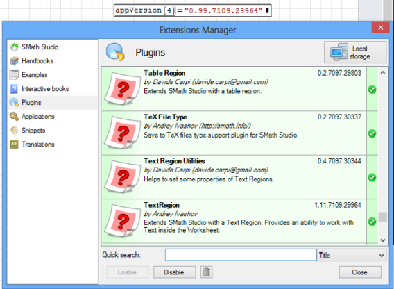

Hi Chris
The green color and the tilde indicate that it is compatible.
When the plugin is not compactible it is shown as the following example.
Why not try the latest version of Smath Studio?
Carlos

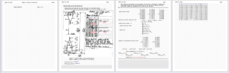

Attached is the subjected worksheet. Please review.
Thanks again!
Chris
Hi Chris, I have downloaded and opened your file, same problem on my PC.
In any case, Table plug-in is still working correctly for me, when opening other files.
So, I'm afraid that in your case the bug is not in the plug-in installation itself, but in the calculation file that maybe got corrupted in some way?
Strange that when I open you file, first page is completely blank, second is a snapshot of a figure/book, third apparently contains nothing more than one declaration, some text and the mentioned error "red box".
Is there no other maths? Or did it get deleted by you? Or maybe by the bugged table?
Bye

Hi Fedeghi:
Thank you so much for trying to help.
I deleted the first page. When the "red box" appeared, it took about 4 pages of content away. Only 2 pages are related to the table region, the rest of them were independent.
Stress Analysis-Moment of Inertia Calculation.sm (27 КиБ) скачан 54 раз(а).
Here is the "table region" as an independent file. It worked fine until I inserted it into the main file.
Thank you!
