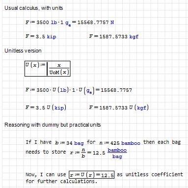

For me units have 2 purposes:
1. Getting quickly understandable numbers
2. Checking errors (unit consistency)
Hi. I agree. Here, a way to get that. Also, notice that you can use almost any other unicode symbol for U(x), or 'U(x), i.e. U in blue.
DummyUnits.sm (9 КиБ) скачан 71 раз(а).

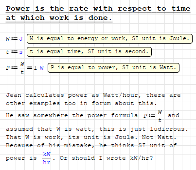

And sometimes that numbers tend to make serious mistakes, like that kW/hr pump power calculation of his.
Not even a typo, he divided 1hr (3600s) to g.e (9.8), found 367 and used it in that abomination.
I have never seen that kW/hr usage anywhere, but interestingly his pump power results have it.
It should even be kW, not even kW*hr. What will be benefit of pump electrical consumption calculation?

Real problem is, some of his engineering calculations, especially unitless ones, have some serious mistakes.
Most of his viscosity related calculations are wrong due to his lack and denial of unit usage.
If he bothered and learned how to use units, he would see engineering is not just operations on given numbers.
Units and their relations are also very important to obtain correct answer at the end of some calculations.
