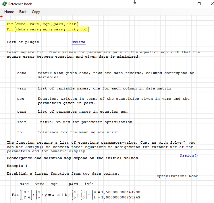

Is there any curve fitting function in Smath?
I mean using the defined points to find the function of these points!
Thanks a lot!
Maxima plugin has the Fit() function, see this post
In the interactive handbook, you find it in the Function Index page.
sergio 14.01.2022 06:15:00
