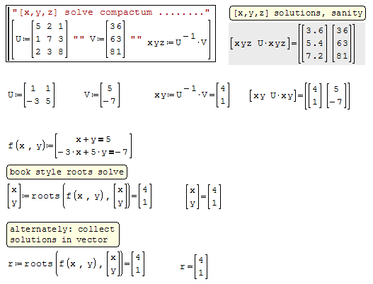

Hi, I am trying to solve this equation
Equation
How can I use the solve(2)/solve(4) function for this?
#2 Опубликовано: 09.01.2020 07:56:09
... like this, simply ... two most direct methods.
Not a case of solve(2), solve(4).
There are more methods than in the attached.
Observe the so much from so little
Solve [x,y,z] Compactum.sm (92 КиБ) скачан 70 раз(а).
#3 Опубликовано: 09.01.2020 07:59:18
115 сообщений из 329 понравились пользователям.
"solve" is only for one-variable functions. You can use "FindRoot" or "roots" as in the attached example solve.sm (6 КиБ) скачан 79 раз(а).
