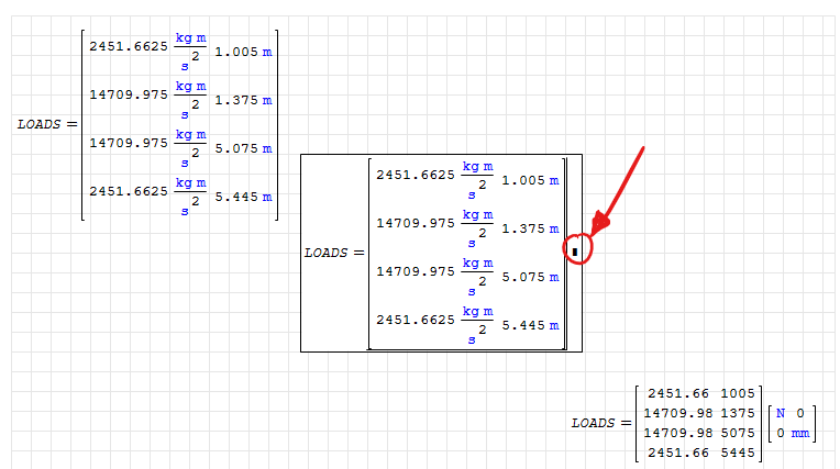

Not sure if I understood but you could show whatever unit is suitable (and consistent) by changing the unit of measure in the displayed results.
Same you would do with a single result, you can change the displayed unit in the black rectangle after results.. only difference from a single formula, is you need to use adiagonal matrix with proper units in proper positions.
At least, this is what I'm often doing to have a clearer view.

It works! Tkank You.
In my case now it looks like:
T := [1 2 3 4 ...] MPa
and that is what I wanted.

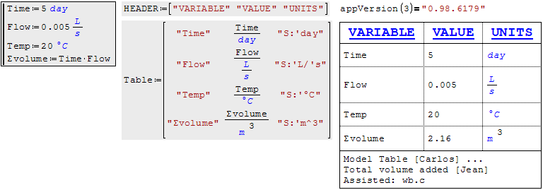

A vector of values can be associated with units.
A data table will have columns units in the header or row wise.

... suggestive examples.
Table Scientific.sm (20 КиБ) скачан 61 раз(а).
Table Medic Data.sm (17 КиБ) скачан 62 раз(а).
Inst_Colebrook Pipe Data.sm (71 КиБ) скачан 57 раз(а).
