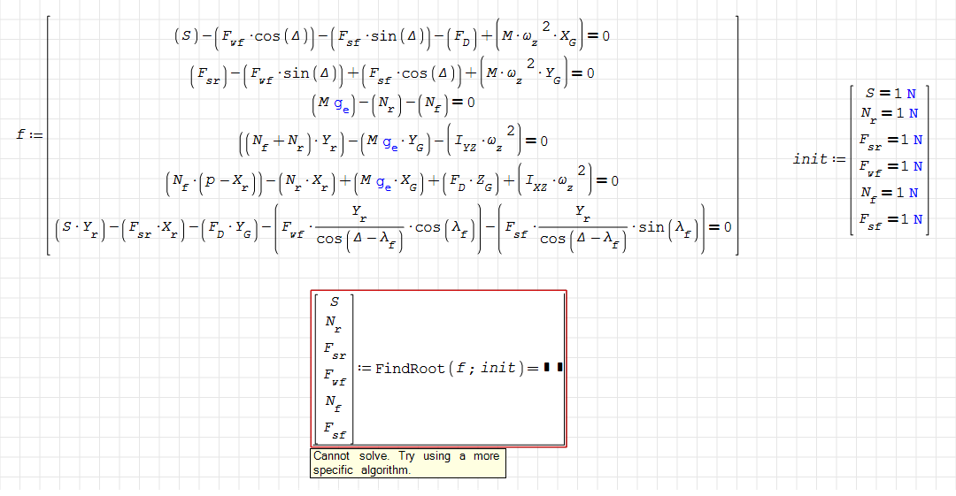

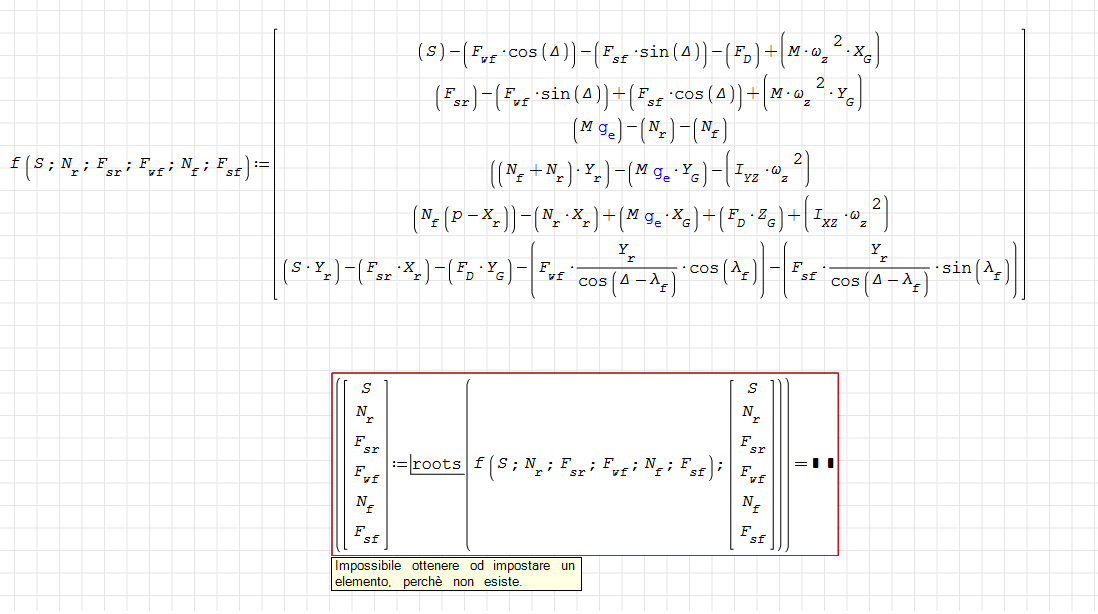

I am having difficulty solving a linear system like in the picture.
the error says:"impossible to get or set an item because it does not exist"
does anyone know where the error can be and how to solve this problem?
Thanks in advance
#2 Опубликовано: 05.11.2019 15:08:12
115 сообщений из 329 понравились пользователям.
"roots" does not work with the units. You must adimensionare equations, or you can try the other features present in the plugin (eg "FindRoot" present "Nonlinear solvers" plugin)

I tried another function but it still gives me an error...

Equations 3 and 4 probably demand different values for N.r+N.f So there is no solution.
If the system has a solution, the function Solve() from Maxima plugin might find it.

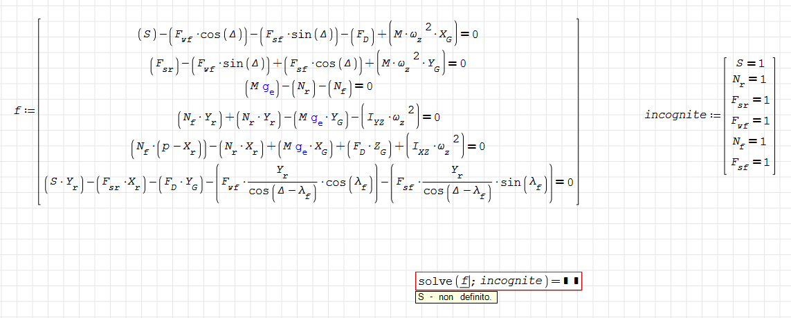

I tried to use the solve function but it still gives me an error saying that S is not defined

Hi, thanks for the reply, but I think I found the error. The system I wrote has two linearly dependent equations, and for this reason it cannot find a solution.
I will have to modify the whole problem.
