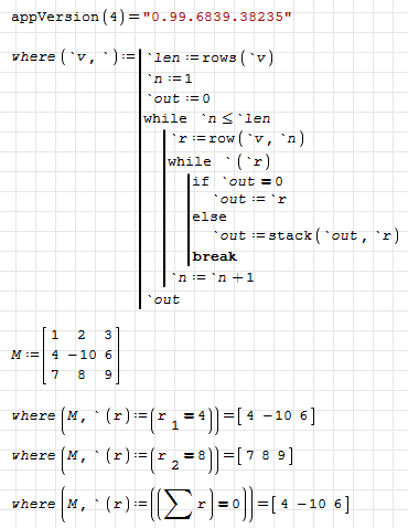

WroteHow can I find on the specific condition of the matrix line numbers or just to get a matrix with the right lines?
The example in the attachment.
Thank yo
The matrix truth table and associates might do and more.
Utilities Matrix Truth Table [Locate row_col].sm (33 КиБ) скачан 48 раз(а).
