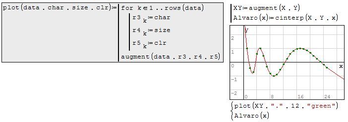

Two red remain ... but here the XY plot.
Cheers, Jean

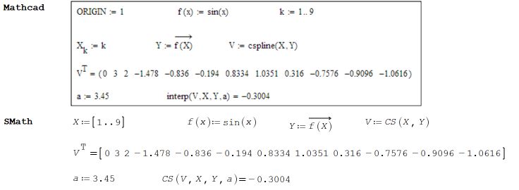

Hi Jean. There are not to much shadow in that small code. It's just the implementation of the traditional spline interpolation. In SMath there are not, or I can't found, the function cspline. The interpolation with cinterp in SMath evaluates the vector V each time that you call it, it's always better to have V=cspline(X,Y) and then call interp(V,X,Y,x). Finally, I want to implement an adaptive step size for the intervals in X. But first I see very convenient to have vectorization and plotting issues solved.
CS only do what mathcad's cspline do:

CS only does what Mathcad's cspline does:
1. You have a good point, but invalid: cinterp(X,Y,x) works faster than Mathcad [I tested long time ago].
2. Not supporting vectorization has only one answer to me:
all that stuff is scalar wrt 'x' for the canvas plot only,
but it is NOT a real scalar function like the built-in ones ... sin(x), cos(x), exp(x) ...
