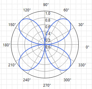

#5 Опубликовано: 06.05.2022 11:05:05
1403 сообщений из 1708 понравились пользователям.
Is it possible to make such a chart with three Y axes on a single chart?
Using X-Y Plot Region, you can simulate your graph with any number of axes, but needs some programming like in this example.
XYPlot. Linear polar.sm (61 КиБ) скачан 84 раз(а).

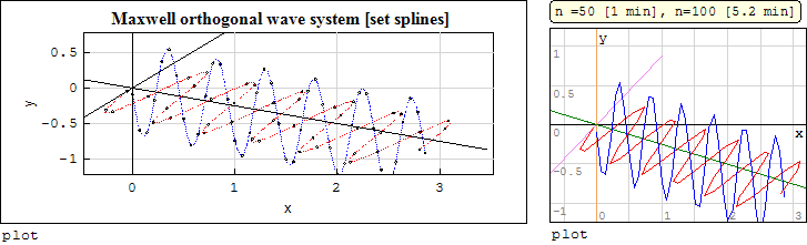

#7 Опубликовано: 06.05.2022 12:19:50
... omitted details:
1. X_Y does not accept Nodes Labels.
2. X_Y splines nicely data set, QuickPlot NOT
3. Both X_Y, QuickPlot accept 3D isometric axes.

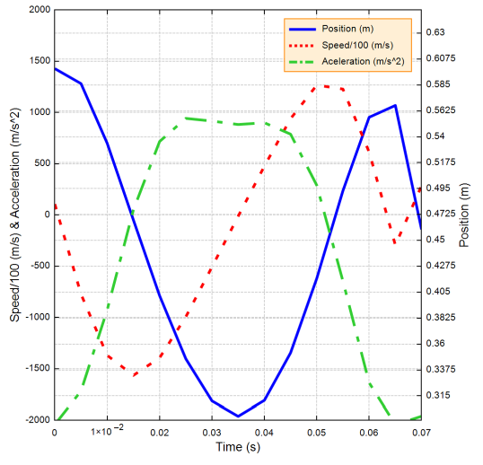

#8 Опубликовано: 06.05.2022 16:02:34
CBG
CBG
77 сообщений из 312 понравились пользователям.
It is possible to use a graph with 2 Y-axes as shown in the image.
Carlos
#9 Опубликовано: 08.05.2022 17:37:38
You can have as many as you want of fake style like the image.
Create Y's as image and slide close to the plot.
You can do lot more Professional ... associate each graph with Nodes Labels.
... as many as you want horizontal/vertical,
disposed inner wrt the Quick Plot
otherwise outside X_Y past build-in default 2.
Utilities XY Label Graph MORE.sm (35 КиБ) скачан 89 раз(а).
#10 Опубликовано: 09.05.2022 08:18:23
... from this factory demo.
Utilities XY Label Graph Y.sm (22 КиБ) скачан 85 раз(а).
#11 Опубликовано: 09.05.2022 10:21:01
... for whatever end use, add margins/calipers.
Utilities XY Label Graph Y factory.sm (41 КиБ) скачан 96 раз(а).

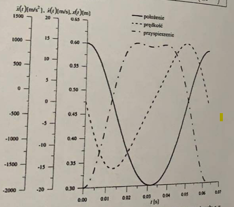

#13 Опубликовано: 10.05.2022 23:48:21
CBG
CBG
Hello
I think your graph could be like this
Three_exes_Graf.sm (32 КиБ) скачан 83 раз(а).
Carlos
