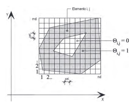

On a textbook I found some applications with a fictitious rettangular domain and a function (theta in the picture) defined from vertices coords, that accounts for the effective boundary.
It certainly works, but maybe there is something more elegant, even for numerical applications ...
You could use finite elements. Create a mesh e.g. of triangles and use some quadrature formula inside the triangles based on some interpolation formula between the vertices (and for second order approximation also midside node). This provides an approximation which gets better with finer mesh.
So what you need is:
  • A triangulation method
  • an generic element integrator and
  • some integration loop over all elements.
The most simple integrator for linear triangles is the average of the nodal values times the area of the triangle, but you also could use some quadrature formula based on internal locations (like Gauss quadrature).
If you have a closed form integral for a single triangle of arbitrary size, then you can create a triangulation just using the boundary points without further mesh generation. The result is exact in this case.
Many thanks for your point of view.
More elegant than what ?
Maths Polygon Area_Perimeter.sm (75 КиБ) скачан 60 раз(а).
1. Construct your 2 polygons.
2. From the big one: subtract area of small from big.
3. That tread goes no where from nothing.
