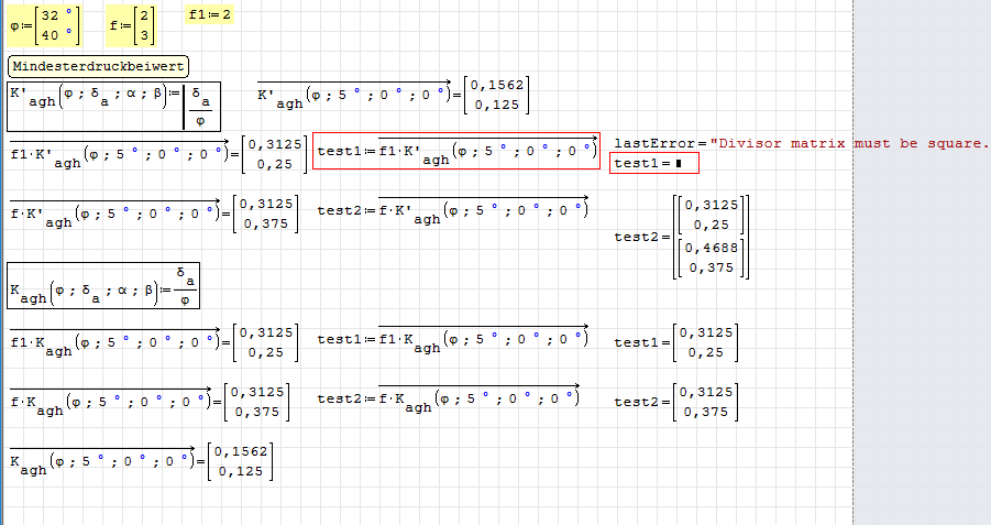

Please have a look a the following example:
The first two results look good.
But why assigning the formula to a variable not work?
And the result test2 doesn't look right, does it?
vectorize.sm (11 КиБ) скачан 113 раз(а).
Thanks for your help!

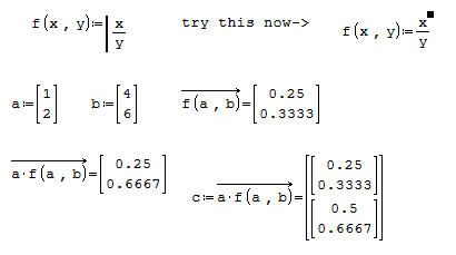

#2 Опубликовано: 15.04.2017 19:12:32
Result is same as if done by hand.
vectorize.sm (11 КиБ) скачан 133 раз(а).
#3 Опубликовано: 16.04.2017 06:46:10
Martin_B
Martin_B
21 сообщений из 84 понравились пользователям.
Probably I don't really understand how vectorize works.
If _I_ would do it by hand,
  • I take the first element of "f" and the first element of "phi" (the two vectors in the expression)
  • I calculate the result and put it as first element in a vector
  • I continue with the the second elements ...
  • I would obtain a two-element-vector
that's what I get by evaluating the expression
vectorize(f*K.agh(φ,5*'°,0*'°,0*'°)
I don't understand why it's a different result if this expression is assigned to a variable.
If the first factor within vectorize is a scalar, the error "Matrix must be square." is shown. But again only if the expression is assigned to a variable.
Everything works fine with functions without the line command. (But it's not possible to to do it without line in every case.)
vectorize2.sm (15 КиБ) скачан 98 раз(а).

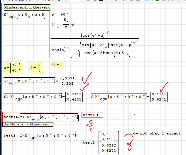

#4 Опубликовано: 16.04.2017 09:42:18
325 сообщений из 2052 понравились и 1 не понравились пользователям.
The problem is in the function definition with or without line environment (as you already noted), and using the function call inside vectorize. See the picture please.
It might be a bit peculiar (maybe a bug) but one should be careful about it. It is advisable to assign the values to variables first and then to use vectorize (not to use function calls with vector arguments inside vectorize). Anyway, your gave an example where one can be easily confused.

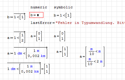

Found another strange behavior (as I think):
Shouldn't vectorize handle 1-element vectors like any other with more elements?
#7 Опубликовано: 24.04.2017 12:26:05
1418 сообщений из 2873 понравились пользователям.
It should. I think I can fix it, thank you (see BTS SS-2443)

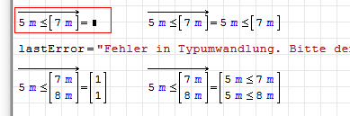

#8 Опубликовано: 24.04.2017 12:58:15
Vectorize operator operates on the RHS of an equation !
Example [1] is oK
Example [2] would not support the RHS of different unit dimensions [m, km ...]
"type conversion not supported".
#9 Опубликовано: 24.04.2017 13:23:12
Martin_B
Martin_B
Example [1] is oK
OK.
Let's put the operator on the RHS and vary the units:
#10 Опубликовано: 25.04.2017 11:24:53
