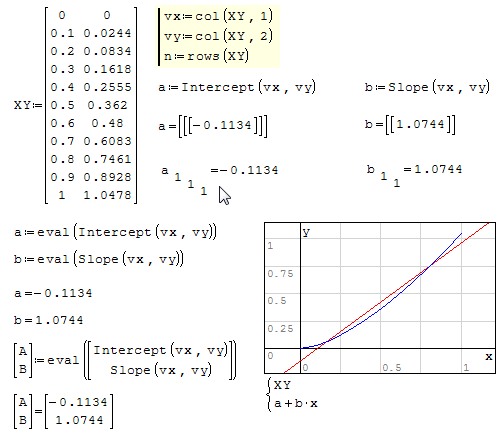

Can't explain to myself double/triple nesting [6179 Win 7].
Bugs SlopeIntercept.sm (10 КиБ) скачан 96 раз(а).

#2 Опубликовано: 07.12.2017 12:13:11
1418 сообщений из 2873 понравились пользователям.
Hello Jean,
something to check in the symbolic engine; change the optimization of a:Intercept(vx,vy) from symbolic to numeric
frapuano 07.12.2017 14:40:00
#3 Опубликовано: 07.12.2017 14:03:58
Thanks Davide ... works fine Numeric !

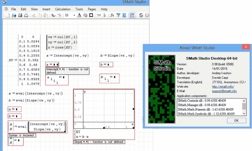

I get these errors when I run the file:
Carlos
#7 Опубликовано: 16.01.2018 00:23:07
Carlos, try this one [done Smath 6179]
Maths SlopeIntercept.sm (9 КиБ) скачан 92 раз(а).
#8 Опубликовано: 16.01.2018 02:02:49
CBG
CBG
77 сообщений из 312 понравились пользователям.
Thanks Jean, but I get the same error.
Is your Smath studio 32-bit?
My Smath Studio 64-bit, does not recognize the
functions of Interception and slope.
Carlos
#9 Опубликовано: 16.01.2018 03:37:52
NDTM Amarasekera
NDTM Amarasekera
Hello!
Jean's example also works in my laptop (Win 10, 64 bit) with latest SS 6588 dated 14/01/2018.
The Functions are in Statistical Tools Plugin.

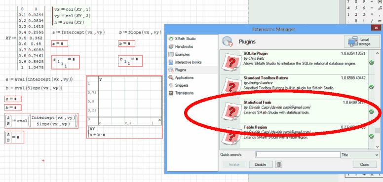

#10 Опубликовано: 16.01.2018 05:36:02
Carlos, do you have statistical tools plug-in installed and enabled?
#11 Опубликовано: 16.01.2018 19:04:34
CBG
CBG
Yes I have it.
Carlos
#12 Опубликовано: 17.01.2018 04:57:25
I see, trying to figure out what's happening here
