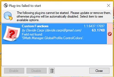

I am experiencing problem in installing CustomFunctions Plugin in SS 6520 (07/11/2017).
Even some items {(such as cases(), abs()}in the Function Index of Reference book have problems.
I am using Win 10 64 bit latest update.
Pl test the attached example.

#2 Опубликовано: 08.11.2017 09:37:35
325 сообщений из 2052 понравились и 1 не понравились пользователям.
Confirmed as well,

#3 Опубликовано: 08.11.2017 15:49:41
1418 сообщений из 2873 понравились пользователям.
Thank you, I'll fix it ASAP. As usual please be patient and keep reporting issues
