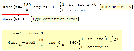

... more general definition of phase:
Project Admittance Copy.sm (155 КиБ) скачан 97 раз(а).

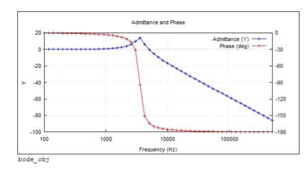

Figured out how to use Maxima's Draw2D(). This also looks nice for a logx plot. Plotted both Admittance and Phase in same graph. I like this as well because properties can be changed directly in SMath sheet.
I played around with XY Plot but was unable to find a way to use log axes.

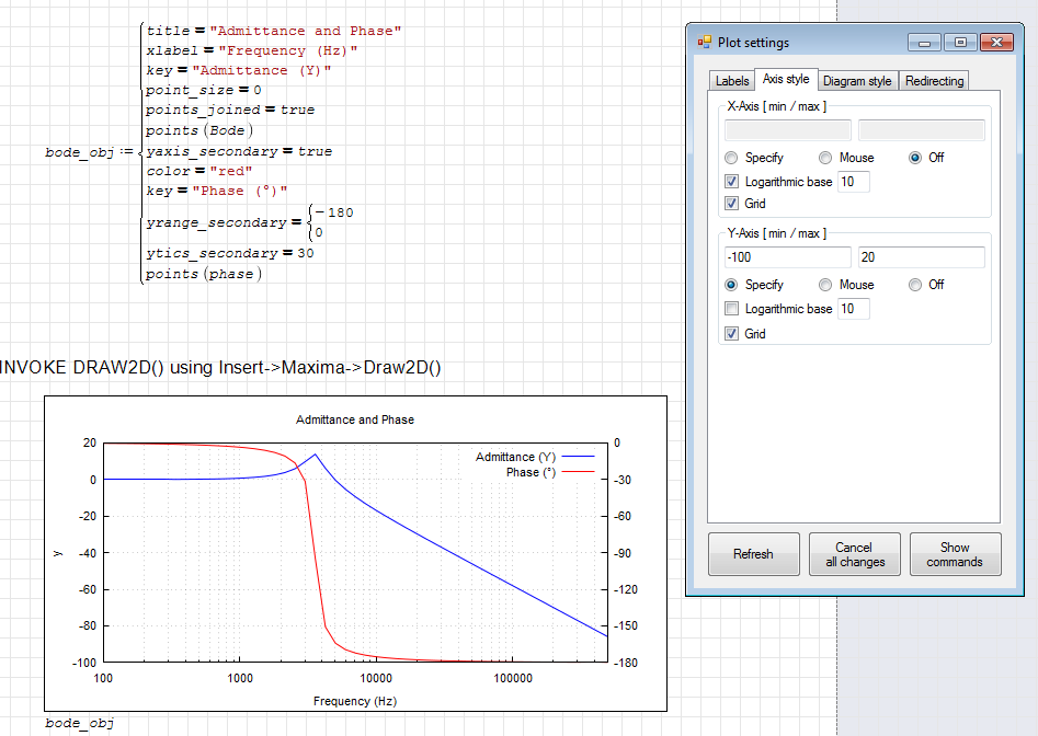

Nice example!
I did a bit of cleanup, removed the markers and shifted some options to the settings dialog.
