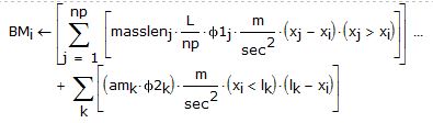

I am trying to convert a Mathcad 15 sheet, and have a problem with the below equation:
Is there a summation within Smath that will do the second summation?

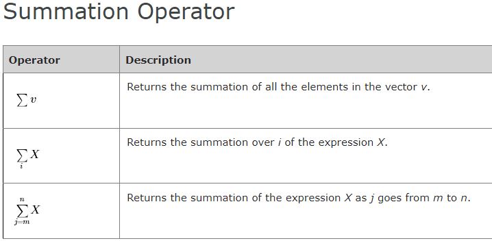

From the Mathcad help:
Thanks in advance

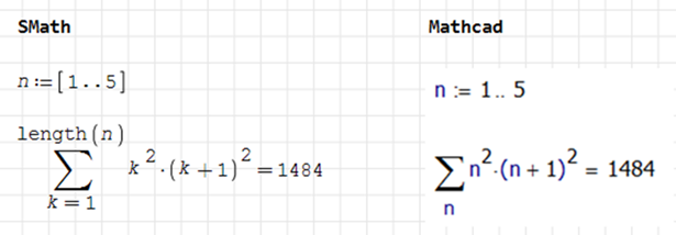

Hi. There are not equivalent, but this is how to convert it into usual summation operator.

Sum over 'n' ... NOT over 'k'
Model summation attached.
Function Running Summation.sm (32 КиБ) скачан 82 раз(а).

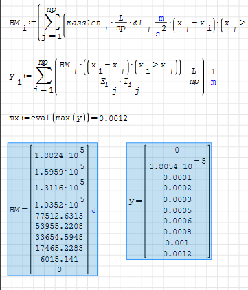

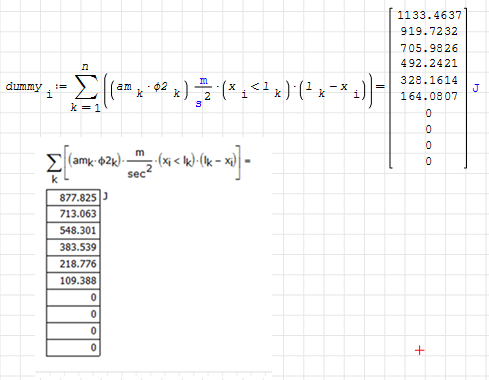

I think that there should be such a replacement.

You can use debugging in both programs to check that the functions are working correctly.
