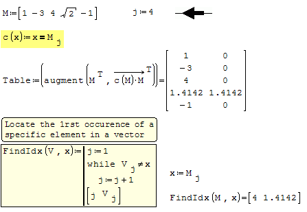

#3 Опубликовано: 27.05.2020 21:03:55
1417 сообщений из 2873 понравились пользователям.
Also
(move the equal in the booleans from the leftmost addendum to the rightmost if you don't want to match zeros from the original vector as positive values)

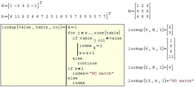

#4 Опубликовано: 27.05.2020 21:56:07
Truth table in more general, multi purpose.
Utilities Matrix Truth Table [Locate row_col].sm (43 КиБ) скачан 63 раз(а).
frapuano 28.05.2020 05:09:00
