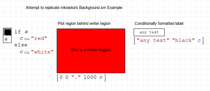

I've attempted to create mkrata's Background.sm example - shown here...
In my attempt below... clicking the Check Box (aka Button) does change the color of the Plot region...
But not the CFL region as it does in mkrasa's example.
I thought it may be an alignment issue but I can't get it to work.
Background Example.sm (5 КиБ) скачан 81 раз(а).
Thanks for any help.

#2 Опубликовано: 14.11.2021 15:53:25
#3 Опубликовано: 14.11.2021 19:12:47
OK, that did it...
I had to look very closely at the choices when I typed in the letter "c" in order to see that the first choice was different from the others which had a blue thing next to them... which, I guess, makes them a "unit" and not a variable.
