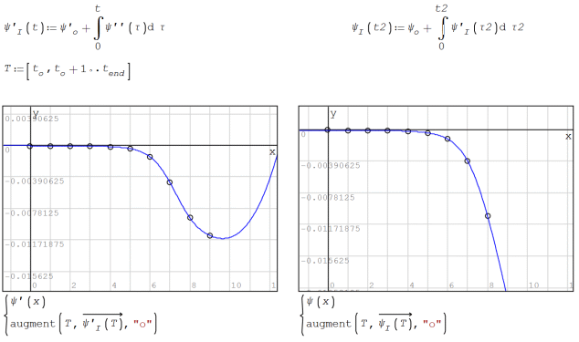

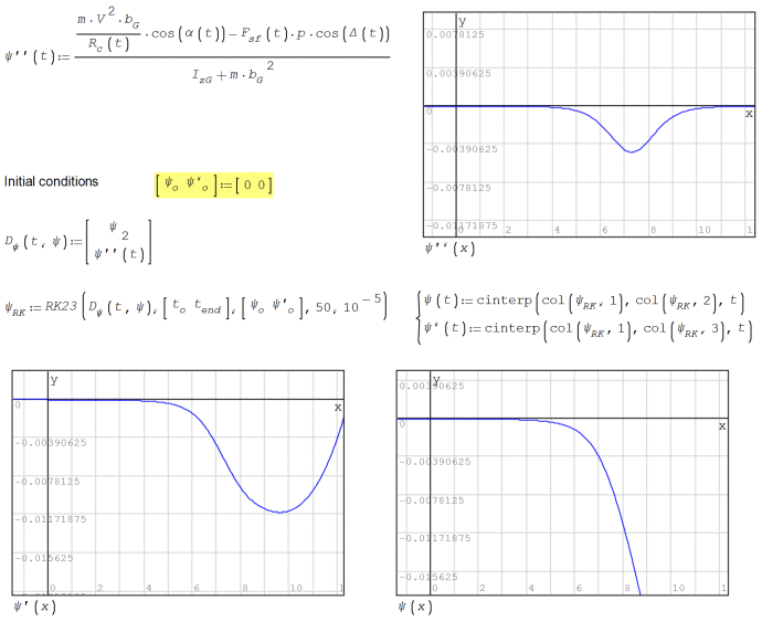

#31 Опубликовано: 28.12.2019 18:49:56
Ale16595
Ale16595
0 сообщений из 35 понравились пользователям.
Hi, sorry if I bother you again. I'm trying to integrate a function, the function in question is psi''(t) in order to derive psi'(t).
I tried using Simpson and Romberg's recursive methods, but without getting a solution.
Where am I wrong?
PROJECT.sm (69 КиБ) скачан 62 раз(а).
#32 Опубликовано: 28.12.2019 21:59:18
You have phi in your document ... psi is a built-in function.
So, if phi''(t) is the 2nd derivative ... then the derivative
is simply the integral. To expedite fast: done discrete.
If you have questions: please re-post this document.
Cheers ... Jean.

#35 Опубликовано: 29.12.2019 11:16:00
Alvaro Diaz Falconi
Alvaro Diaz Falconi
Where am I wrong?
Hi. You can use any Runge Kutta solver for integration.
Also, you can use SMath int procedure, but it's very (very) slow:
For the theory, remember that you can integrate (with definite integrals) both sides of an equation and get an equality too, which don't work with derivatives.
PROJECT.sm (74 КиБ) скачан 65 раз(а).

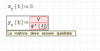

#36 Опубликовано: 29.12.2019 11:21:10
Ale16595
Ale16595
Hi, I have calculated the function psi '(t) through dn_GearsBDF.
But now I can't calculate the ratio in the picture.
The error says, "The matrix must be square"
PROJECT.sm (57 КиБ) скачан 51 раз(а).
#37 Опубликовано: 29.12.2019 14:19:55
Result from numerical ODE solvers is a data set.
Generate an interpolation scalar to 'x' ... then plot.
@ the end of the document ... more questions: -this one.
PROJECT (1).sm (74 КиБ) скачан 68 раз(а).
