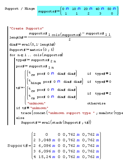

Can you take a look at the attached (scroll down to you see big red text with "problem with cases". I seem to be having a problem with cases(). Maybe there is a better way in general to handle this situation.
Thanks again for your help Martin.
FEA Beam - Decon - Preprocessor.sm (125 КиБ) скачан 102 раз(а).
#7 Опубликовано: 08.02.2015 16:19:44
Switch the optimization to numeric (use an eval when you are inside a loop), otherwise you can't mix numbers and strings...
moreover matrix(#,0) is not supported (0 columns) and is converted by SMath into a mat(#,0) - that is a broken mat() function
About units, I think you may define "design base units (lenght/mass/force)" on the top of your worksheet, like in a common FEM program...
FEA Beam - Decon - Preprocessor.sm (127 КиБ) скачан 85 раз(а).
#8 Опубликовано: 08.02.2015 22:02:28
Davide, Thanks for the reply.
First let me establish the problem.
I have and input matrix w.p# in which you can define a partial uniform load, a triangular load or a trapezoidal load. However, I need to break down any trapezoidal loads into a uniform load and a triangular load. Therefore I need create a new matrix (change the origonal) which will have 2 columns for every trapezoidal load.
I see your adjustments and at first I had done this. However this creates a "0" column vector for each load, whether it was uniform, triangular or trapezoidal. I was trying to avoid these extra '0' loads by stacking and defining the matrix as "nothing". Similar to how Martin initializes a matrix E=matrix(0,5) and then stacks it will other matrices. I attached another worksheet for reference but it appears the problem is the 'nothing' matrix.
Beam FEA - partial load cases.sm (33 КиБ) скачан 103 раз(а).
#9 Опубликовано: 09.02.2015 11:55:00
You're welcome
Excuse me, but as an engineer your approach seems to me unnecessarily complicated
Why you don't use something like in the attachment? [you may also extend it with a 2nd if statement to check if the load is triangular]
Beam FEA - partial load cases.sm (35 КиБ) скачан 89 раз(а).

What is the best way to implement this. For some reason I can't seem grasp the best way to insert or remove rows from matrices (which is a big problem for most programs!)...
If I understand correctly the FEM beam function... to create a "Fixed" support I need to have a t.cw and a t.cphi at the same position. Therefore I need to create a new matrix with an extra support "type" at the same position. What is the best way to do this? See attached for portion of the routine that I am referring to.
Thanks!
Beam FEA - Support inserting into matrix.sm (8 КиБ) скачан 95 раз(а).
Thanks!

Well here it is. Not sure how stable it is as I have only limited testing. I wish the graph was easier to move around.
My next effort with be to allow multiple E, I inputs, but for now I will use this mostly for simple span beams.
I also want to create a "steel beam size optimization routine". The problem though is importing the steel beam sizes and properties. The matrix is just so large that it really slows the calculation down.
BeamFEA_1 Input-Result.sm (39 КиБ) скачан 109 раз(а).

RFreund, any instructions on how to use those files? I just get errors without changing any parameters, seems something is missing.
#19 Опубликовано: 29.03.2015 09:30:33
I will work on some instructions, sorry about this.
They need to be used in the same work sheet. I've attached them in the same sheet. The idea is that the input and result can be used multiple times on a page, for multiple beams. In order to get the graph to work you must click on it, then right click, select template "T", right click again, select predefined layout "P". I actually don't use the graph, and am working on trying to track the reactions at the reactions (more on this later).
I seam to have left out the input graph (included in the attached)
Things still to impliment:
1. There are variables used in the functions which are still "dangerous" because they can be used outside of the function and cause errors. Namely I have found "l" (lower case "L") to be an issue.
2. Allow input for a change in E and I for different spans. I'm not sure the best way to setup input for this. Right now I really wanted something for simple beams.
BeamFEA Functions - Input and Result.sm (238 КиБ) скачан 156 раз(а).
