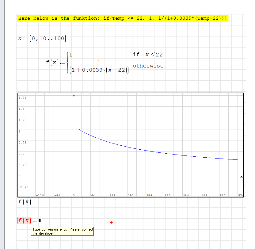

Hello everybody,
I use a beta-Version of SMath and have a question regarding the message:
"Type conversion error. Please contac the developer"
Problem_with_the_function.sm (4 КиБ) скачан 59 раз(а).
Best regards,
Andrey

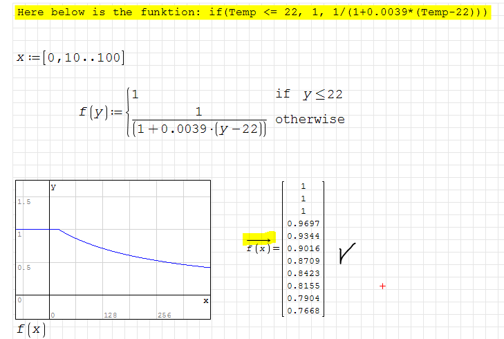

Do you want to get this result?
Problem_with_the_function_ser.sm (4 КиБ) скачан 62 раз(а).

Thank you very much, Sergio!
Yes, that's what I wanted to get.
