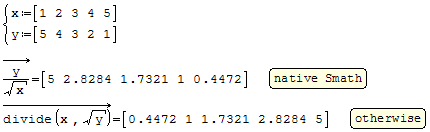

Is there any way to present division on the same line and not as a fraction? For example in Mathcad:

Is there any way to present division on the same line and not as a fraction ?
Maths Infix DIVIDE.sm (4 КиБ) скачан 56 раз(а).
Answer is NO, Smath does not have native ÷ operator
More productive from infix algo style utilities,
for infinite in-situ command line.
infix Divide.sm (3 КиБ) скачан 44 раз(а).
