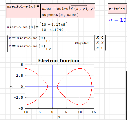

Interesting the implicit/recursive discrete solver.
Few more techniques/tools in these two Smath documents.
Contour SOLVE [user].sm (46 КиБ) скачан 98 раз(а).
Contour SOLVE [at(2)].sm (174 КиБ) скачан 101 раз(а).

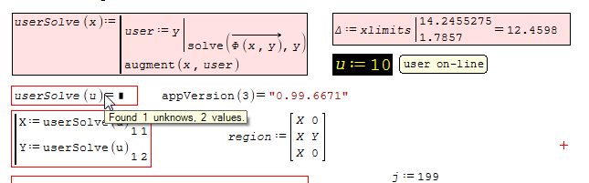

Hello Jean,
Just for the record, without to much insight into the problem. Unfortunately, your recent examples do not work for me.
#4 Опубликовано: 28.06.2018 10:53:59
Hello Jean,
Hello Doctors ! please help Radovan.
The error message does not indicate an error in the transmission.
Please, re-download these [3] that have same solver or otherwise.
Project Solve Ejector.sm (19 КиБ) скачан 91 раз(а).
Contour SOLVE [at(2)].sm (172 КиБ) скачан 93 раз(а).
Contour SOLVE [user].sm (65 КиБ) скачан 84 раз(а).

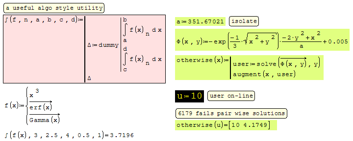

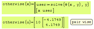

Hello Jean,
I just removed at(). Is this all right?
#6 Опубликовано: 28.06.2018 20:23:00
Hello Jean,
For sure, more than correct as your solve(,,) gets pair wise solutions.
Yes, the lobe is symmetric around the 0 datum.
#7 Опубликовано: 28.06.2018 21:08:22
... now I get pair wise solutions. But not augment !
