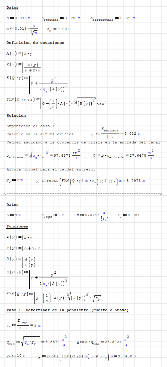

I need to pass these codes that are in Mathcad Prime to Smath, does anyone know how I can do it?
I need to pass these codes that are in Mathcad Prime to Smath, does anyone know how I can do it ?

But the programming is the same in Smath? I mean, for example the FYN or root function still works?

But the programming is the same in Smath ?
I mean, for example the FYN or root function still works ?
Smath has many solvers. FYN from implicit roots(,,,).
roots will solve on the canvas [MACH number]
