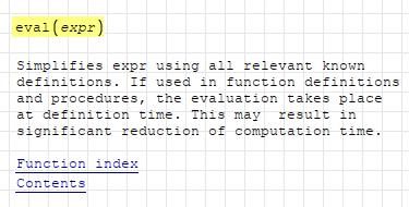

Is there a reason why Dy is within in eval()?
eval() makes computations faster most of time.
Very minor times, may have no effect or slows the calculation.
It would be wise to choose where and when to use it.

  • eval() for faster calculations

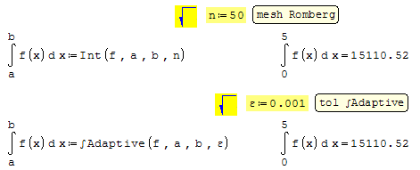

#22 Опубликовано: 26.12.2021 15:35:23
1. as well, you can recast the function name.
2. and use algo style to be more pro.

#24 Опубликовано: 27.12.2021 12:32:32
That's what I meant by recast, last page of the attached.
Cheers ... Jean.

#25 Опубликовано: 27.12.2021 17:19:04
