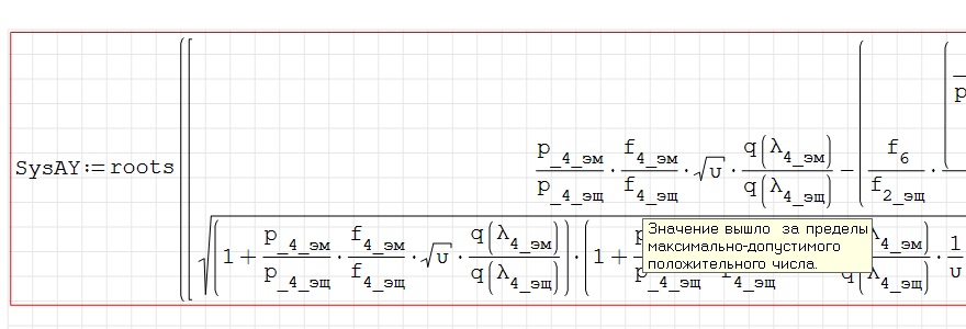

Who has faced such a problem, how can it be solved?
Project from below

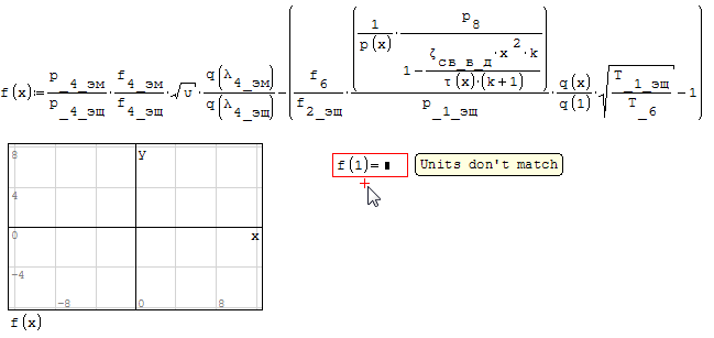

"result above max ..." has no pertinent meaning in your project.
If you attempt "roots" on the numerator only ... "Units don't match"
No need to go further ... zap the units in the project.

Same answer: Units don't match.
How can you solve what you can't plot or evaluate ?

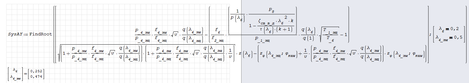

You can use the function FindRoot() from the Nonlinear Solvers plugin. The function automatically assigns the solution to the variables.
Единицы измерения здесь не при чем.

why do you use 0.2 and 0.5?

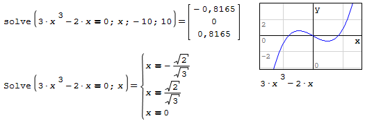

Go on dreaming. If you are in non-linear systems and you can't find a symbolic solution (Maxima's Solve() got stuck when I tried) then you need numerical procedures for solution. These always need an initial guess (Newton-Raphson) or a search region (bisection). The various procedures just differ in how efficient or how robust they are. Some of them may have quite impressive radii of convergence for particular systems but none has infinite radius for all systems.
Furthermore, there remains the problem of uniqueness of a solution. The only solvers in SMath capable of providing multiple solutions are the
  • solve() finds all solutions of a single equation within a given range
  • Solve() from the Maxima plugin, which finds symbolic solutions.
Blatt21.sm (5 КиБ) скачан 58 раз(а).
#12 Опубликовано: 15.02.2020 12:10:50
Quite right and not enough wrt complex roots.

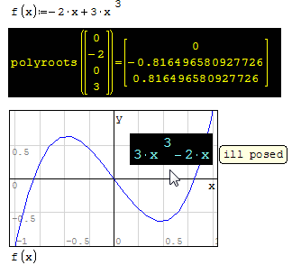

Always avoid ill posed polynomials.
