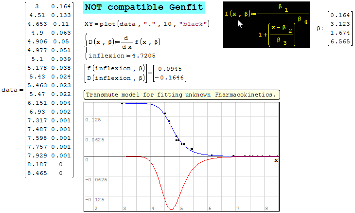

Data set from Art [Mathsoft Collaboratory], unexplained, no abstract.
Bonus in this Smath document: Min/Max Golden ratio.
Seemingly, the fit may be adjusted so that the min derivative be
exact wrt the reference start point [3, 0.164] ... not offered.
Genfit Difficult Pharmacokinetics.sm (25 КиБ) скачан 74 раз(а).
#2 Опубликовано: 15.08.2018 10:18:52
... => here is !
Genfit Difficult Pharmacokinetics.sm (25 КиБ) скачан 73 раз(а).
