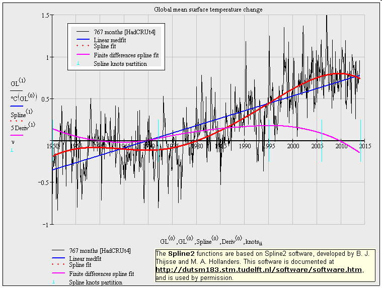

Smoothing is a rescue tool when no fitting method
is productive [model global, model piece wise ...].
1000's of data sets got well done Mathsoft Collaboratory.
I'm just addict to data.
Cheers, all the best.
