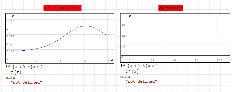

Hello everybody.
I can't understand why the phi function does not compare in the graph.
This function is the derivative of the phi function that instead appears in the graph.
Someone could help me please?
Thanks in advance
this is the file… Derivate.sm (22 КиБ) скачан 58 раз(а).
#2 Опубликовано: 10.12.2019 12:31:00
1. your φ(t) plots correct
2. The Smath derivative operator works on derivative rules.
3. The φ(t) is too much a monkey business for derivative rules.
4. Rescue via transit infinitesimal analysis.
5. Your constrain in plot argument is obsolete since if/otherwise
was introduced by Davide from f(x) menu "cases".
Derivate (1 doctored).sm (24 КиБ) скачан 56 раз(а).
