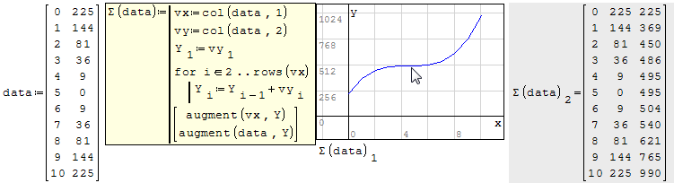

In the attachment at the start of Page.5 I (so far) am unable to construct a loop or something that cumulatively adds vector elements down the column. So I am manually doing this for now, any ideas?
I have started additions from the 6th element because first x4 were zero ...but I think you get the idea!
https://imgur.com/7KSBDM8
Secondly in the last page there is a 2D-graph. One can easily read the intersection of two lines however is there any solution to find the intercept of two lines when they aren't functions but are rather data points?
Remembraning.sm (38 КиБ) скачан 67 раз(а).

no no ...I think I was unable to make you understand. The summation gives one value ...instead I wanted to have a cumulative elements in a vector. The latter thus can be plotted. please revisit the screenshot

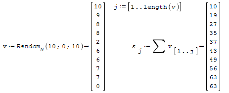

Sum the vectors and vectorize ...
#6 Опубликовано: 23.04.2018 16:48:03
... as you wish
#7 Опубликовано: 23.04.2018 16:56:06
Maths Vectorize.sm (9 КиБ) скачан 95 раз(а).
#8 Опубликовано: 23.04.2018 16:56:33
usamakhan
usamakhan
3 сообщений из 75 понравились пользователям.
Thank you PompelmoTell

Jean Giraud, why do you add Line in the following code, I mean why not just type them separately or am I missing something?
Yes my friend, you are missing best using Smath feature,
1. the line | collects/instructs the project
2. the { collects for plotting
Visit attached Project PR EOS.sm
Here is your plot and cumulative.
Project PR EOS.sm (129 КиБ) скачан 78 раз(а).

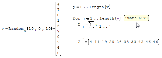

#15 Опубликовано: 24.04.2018 00:28:22
You are right: Martin latest version throws error in my 6179.
Try that in your version.

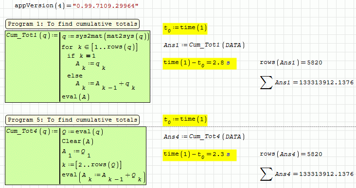

#16 Опубликовано: 09.08.2019 03:16:20
NDTM Amarasekera
NDTM Amarasekera
[albumimg]1481[/albumimg]

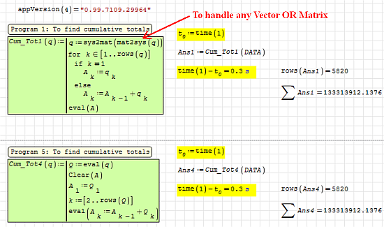

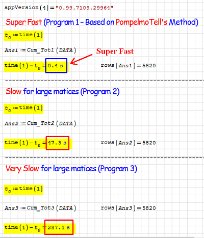

I tested 3 programs to find the cumulative totals of a large array of 20820 elements.
The method of Sergio was incredibly fast, while other two methods were much slower.
Thanks Sergio.
Forgot to attach DATA file
Rainfal_Data.xlsx (486 КиБ) скачан 56 раз(а).
Cumulative Sum of a Large Matrix.sm (30 КиБ) скачан 68 раз(а).

#18 Опубликовано: 09.08.2019 11:33:32
NDTM Amarasekera
NDTM Amarasekera
Hello Alvaro
I get following result in my laptop.
Yours is a very good alternative.
Thanks.

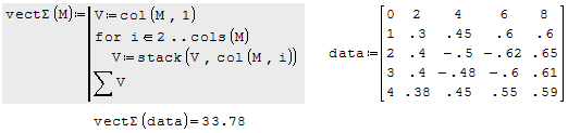

#19 Опубликовано: 09.08.2019 13:31:37
... the word is array
1. Unwrap the array in vector
2. ΣV ... vector sum over the unwrapped array
SS 6179 does not open your document.
#20 Опубликовано: 09.08.2019 19:12:35
...more and otherwise.
vectSum.sm (15 КиБ) скачан 58 раз(а).
