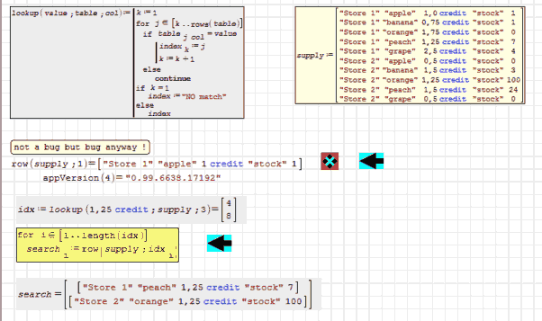

Hello Jean
The version "0.99.6638.17192" of Smath Studio does it correctly.
I also propose a small change in the variable "Search"
Carlos

Thanks Crlos,
Your'e right: just search for what is demanded.
