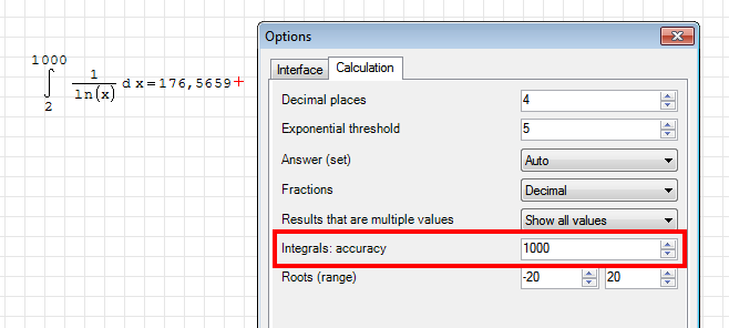

Hello [userlink]Joey Ooi[/userlink],
You have to set a better accuracy in the global options (tools >> options >> calculation)

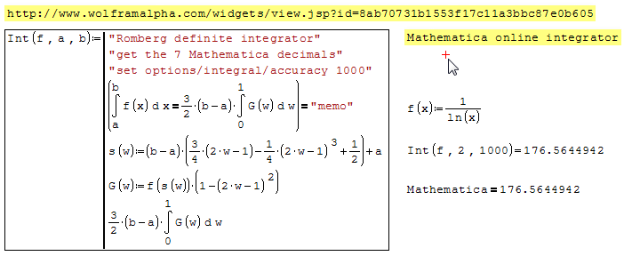

#4 Опубликовано: 23.05.2017 07:53:55
Any idea what could be the problem?
Smath Simpson iterative integrator is known to range from
exact [sometimes] to poor. Increasing accuracy is fine in
this example but will not converge in other instances like
in the Fourier Quantum double integral. You can rescue
your example using the attached Romberg.
Mathematica online integrator link added.
Integrate Mathematica.sm (9 КиБ) скачан 63 раз(а).
#5 Опубликовано: 23.05.2017 08:37:48
... revisit same work sheet for the 7 decimals !
Integrate Mathematica.sm (10 КиБ) скачан 60 раз(а).
#6 Опубликовано: 23.05.2017 08:53:58
... like this
