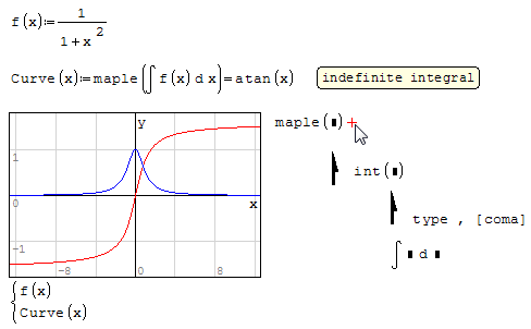

How do I integrate symbolically ?
Generally, like this.

#3 Опубликовано: 10.05.2018 22:35:04

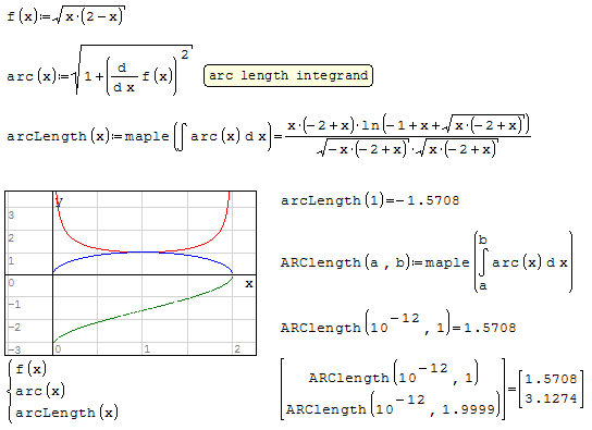

... more procedures.
Integrate_000000 [ Source Code Maple].sm (9 КиБ) скачан 338 раз(а).
#4 Опубликовано: 11.05.2018 00:03:19
Ryu945

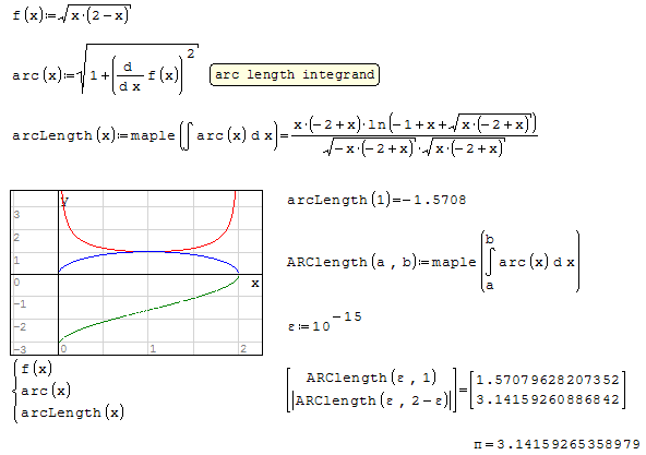

For reference, I just installed SMath. I installed maple. Where is the integrate sign located in the program?
