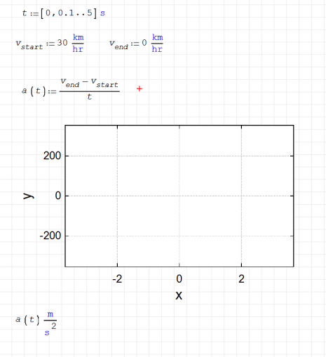

Hi All,
Could you direct me how to plot the function for some range?
plot in range.sm (5 КиБ) скачан 80 раз(а).
Best regards,
Astroneus

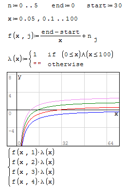

#2 Опубликовано: 28.06.2021 20:27:01
Fridel Selitsky
Fridel Selitsky
Speed graph
Phisic.sm (6 КиБ) скачан 88 раз(а).

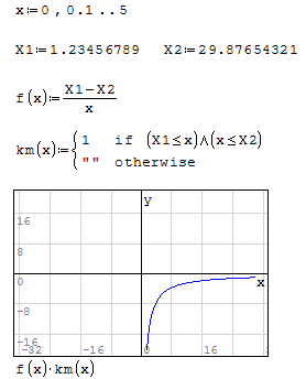

#3 Опубликовано: 28.06.2021 20:27:21
X_Y plots f(x,y)

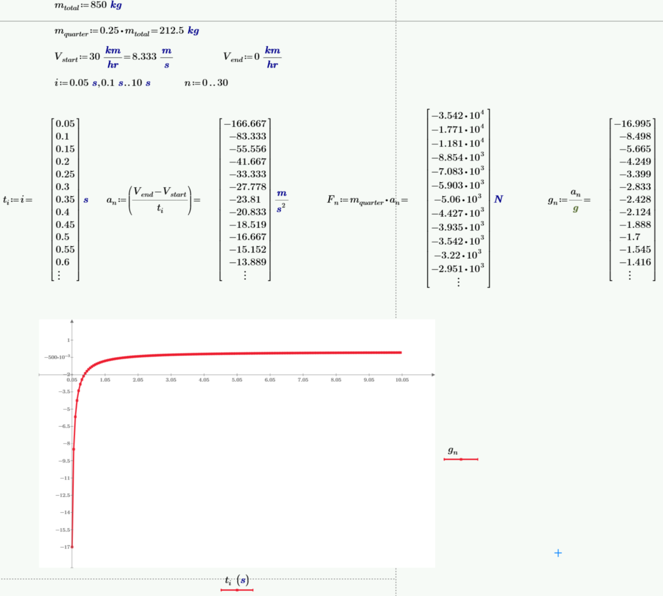

It looks like that both solution are not what I want to get - especially the first one...
Is there any possibility simply to plot the chart where on Y-axis I simply put the a(t) and on x-axis time??? Because this what you proposed it looks tricky and there is necessity to control units. Therefore it is not intuitive ( at least for me ;P )
Please check the photo below made by ptc mathcad. This what I want to do, is to write the same as the function and plot it using the SMath.
If that plot is what you need, here is your answer.
With function, dots for values and new axes grid {0.05, -2}.
plotting_range.sm (10 КиБ) скачан 86 раз(а).

Hi Ber7,
This the acceleration during the breaking from 30km/h to zero in linear movement. Therefore in fact there is a(t)= v(t)/t. So: a_i= v_i / t_i and this is function where t is in some range, and i is the iterative change of time ie. the position of specific time. This what you wrote, is not the function of acceleration versus time.

@ Jean Giraud and @overload Thank you !
This is what I wanted to write in SMath!
Make your deceleration as you wish from a pre-selected vector 'a'.
#11 Опубликовано: 29.06.2021 11:17:05
This is what I wanted to write in SMath !
Differently convenient plot ...
plotting_range [1].sm (11 КиБ) скачан 109 раз(а).
