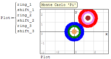

#5 Опубликовано: 02.02.2020 14:33:18
Roman
Roman

... often in real Engineering works:
Discretize => transit to file.

#16 Опубликовано: 28.02.2020 10:21:58
As interpreted ... ?
1. You can have as many rings as desired, sizes as well.
2. It may be profitable to transit/spool to file.
3. You may have in any Web colors from otherwise construction ?
4. Rectangle may be added ?
Circle Monte Carlo.sm (24 КиБ) скачан 52 раз(а).

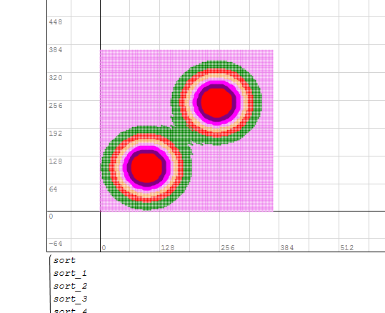

#17 Опубликовано: 28.02.2020 11:40:50
2 confirmations:
1. Spool to file YES for recovering from other document.
2. Web colors YES from code ... somewhat greedy !
Circle Monte Carlo.sm (32 КиБ) скачан 64 раз(а).
#18 Опубликовано: 02.03.2020 17:43:34
... a much faster version.
Circle Monte Carlo.sm (33 КиБ) скачан 60 раз(а).
