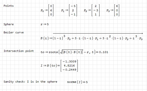

Hi. In the attached how to solve the problem numerically. Notice that B(t) must to be defined using vectorize, because SMath don't expand the scalar by vector products.
Sphere and Cubic.sm (8 КиБ) скачан 79 раз(а).

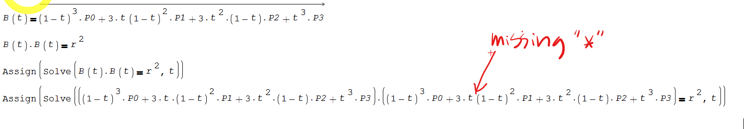

There is missing «²» after second parentheses in your file. And I downloaded SMath and Maxima, but when I open your file, I get an error: «Cannot find maxima.bat».
Sphere and cubic Bezier curve intersection points.sm (3 КиБ) скачан 80 раз(а).
Please refer to Maxima plugin instructions, you can find here
#12 Опубликовано: 16.09.2021 08:18:04
Necronomicron
Necronomicron
OK, I've fixed the error, but now it says: «r is undefined». Sorry, it's really hard to understand what to do and I can't find any proper docs about it...
Sphere and cubic Bezier curve intersection points.sm (4 КиБ) скачан 75 раз(а).

I really don't get what's wrong now...
Sphere and cubic Bezier curve intersection points.sm (12 КиБ) скачан 84 раз(а).
There is a missing "*"
#15 Опубликовано: 16.09.2021 11:07:40
Necronomicron
Necronomicron
Thank you! But what should I do with «r is undefined»? 🤔

Hi. Notice that P0, ..., P3 are vectors with 3 components, not scalars. You can't get the distance with B(t).B(t) using P's as scalars.
