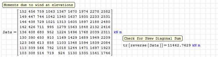

Is there a built in function that can get the sum of the upper secondary diagonals of a matrix? some times called the skew:
I can call each by its element, but I would like it to work for any a1n & an1, I can do tr(reverse) to find the secondary diagonal, after each reduction of the matrix by 1 row/column:
matrix multiplier.sm (15 КиБ) скачан 56 раз(а).
Thanks in advance
Ian

Lets say the matrix is 10 x 10, I don't want the user to have to "manually" create all the steps to get to the tr(reverse), this is a lot of work and could introduce errors. What I want is a simple (if it is indeed simple!) loop to do it.
Your solutions certainly speed up the process and wonder if they could be implemented?

... your image red arrows represents the *.JPEG destruction.
JPG does not compress, it destroys the details bottom-right up top left.
What's the relationship between your JPG image and your attempt ?
Image jpeg.sm (53 КиБ) скачан 51 раз(а).
Hi Jean,
The image was just to illustrate the direction of the summation, the primary diagonal is top left to bottom right.
Hi Carlos and Davide,
These look like interesting solutions, let me try on the larger matrix.
Thanks once again
Ian

Interesting results on the speed of calculation:
Main Matrix:
Method Carlos:
Method Davide:
Comments?
