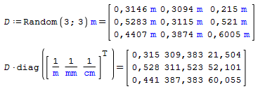

But now I want to export data to an Excel sheet, and afterwards to treat that data as numbers without unit (Excel works like that).. so instead removing the unit in Excel, I was just wondering if in SMath would be a function to do it before exporting
Best regards,
Zigor
#4 Опубликовано: 31.01.2020 09:30:23
1222 сообщений из 2150 понравились пользователям.
Assuming you have a table with columnwise uniform units, then the following approach provides full control:
exportdata.sm (4 КиБ) скачан 64 раз(а).
