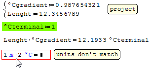

why you type an additional "'" between temp and °C ?
It is enough to type: temp*'°C=
#7 Опубликовано: 16.09.2021 12:48:50
To make the unit silent but responding.
Had been used/demonstrated ad nauseum.
Most useful in program, still conveying meaning.

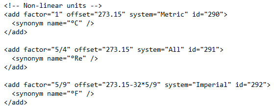

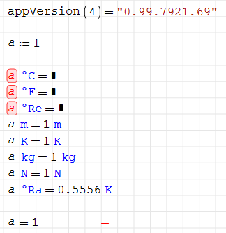

Very strange, seems to be °C, °F, and °Re.
Interestedly enough, these are the units labeled in the units.xml file as nonlinear. I don't know what any of this means, but I'm sure it has something to do with the built in functions that get us these three units.

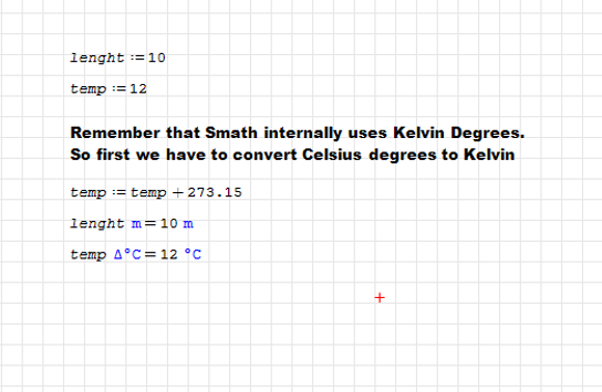

Hello
I think the following can be done
Carlos
Oscar Campo 16.09.2021 18:16:00, Porschaka 17.09.2021 08:06:00
