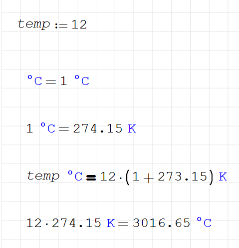

It may be a bug because it doesn't evaluate. But what should it evaluate to?
My argument would be 3016.65 degC!

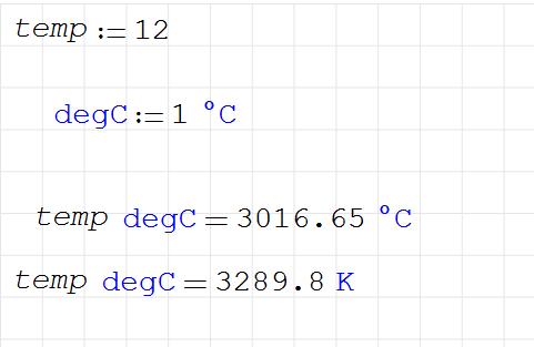

#25 Опубликовано: 17.09.2021 17:07:41
Arie
Arie
93 сообщений из 285 понравились пользователям.
Workaround that preserves units.
Also confirms my assertion above.

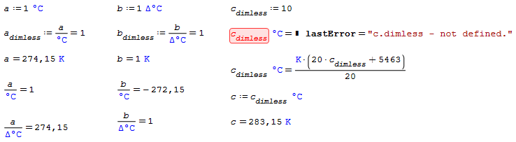

#26 Опубликовано: 19.09.2021 11:46:58
1230 сообщений из 2155 понравились пользователям.
Multiplying a variable by a nonlinear unit seems to make SMath forget or ignore the definition of that variable in that cell. Thats a bug for sure.
However, if you store that multiplication in another variable and then evaluate that in another cell, the original variable is again in the context and the correct result is shown. Thus, separation of definition and display via storage in a new variable is a possible solution to the original problem.
If it is just about parallel usage of dimensional and non-dimensional quantities, then just swapping definitions might also help.
This means deriving the non-dimensional quantity from the dimensional one instead of the other way around.
