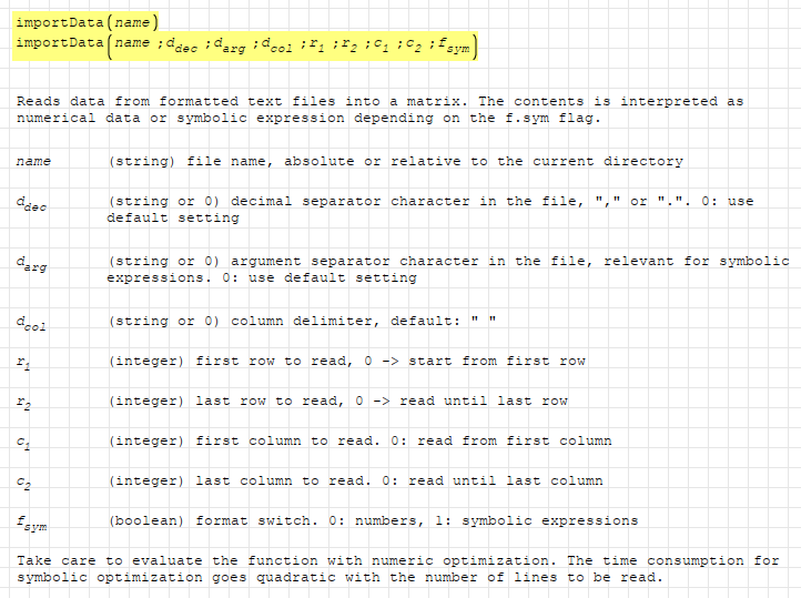

If you mean a comma separated file (csv), yes it is possible with importData().

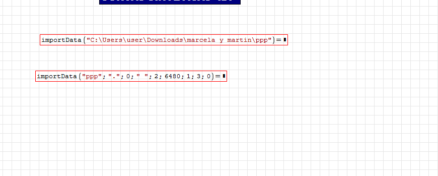

I allow your instrruccions, i dont know if i am doing ok, the name of the file is "ppp" and it shows me in the smath studio thats it is not reconized.

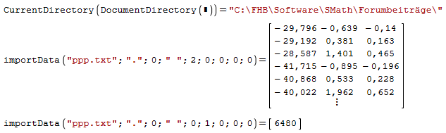

#6 Опубликовано: 17.06.2021 16:27:20
555 сообщений из 1333 понравились пользователям.
this it is the file, thanks for your help
ppp.txt (168 КиБ) скачан 92 раз(а).
You should write "ppp.txt" where you indicate your file.
You also just have to delete the first line from your data file.
It creates conflict between your function and data.
Data it provides don't match pattern of function.
So in result data can't be read.
Check below.
Показать спойлер
PS: martin is also right about getting partial data down below.

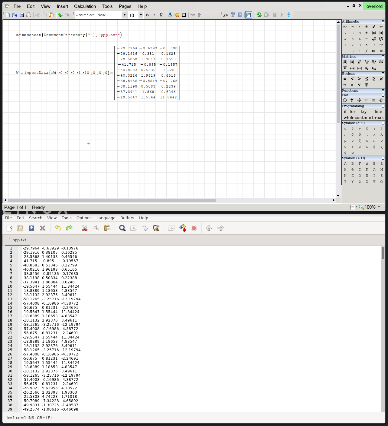

#7 Опубликовано: 17.06.2021 17:12:18
1230 сообщений из 2155 понравились пользователям.
You can access differently formatted sections by reading them separately.
