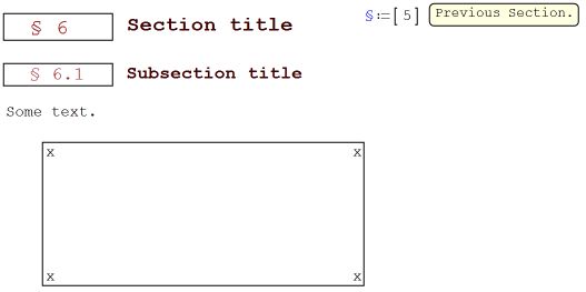

Hi Basile. You can start from any paragraph pointing the value of the variable '§, for example from paragraph six is: '§:mat(5,1,1)
For paragraph 1 use zero as starting value.

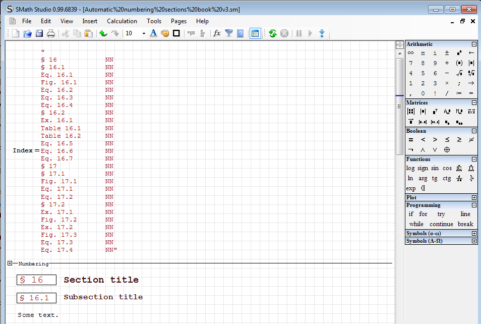

You can display the index at the begin of the document if you assign it to an absolute variable at the end (those variables starting with a tilde ~)
On german keyboards, the tilde has to be copied from a text region as it is catched as a hotkey for boolean = in math regions).
BTW, why don't you use formatted labels?
![2018-10-01 09_58_08-SMath Studio 0.99.6839 - [Automatic%20numbering%20sections%20book%20v3.sm].png](/ru-RU/file/S7nvyG/2018-10-01-09_58_08-SMath-Studio-0_99_6839---_Automatic_20numbering_20sections_20book_20v3_sm__png)
Automatic%20numbering%20sections%20book%20v3.sm (40 КиБ) скачан 117 раз(а).
