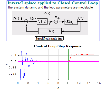

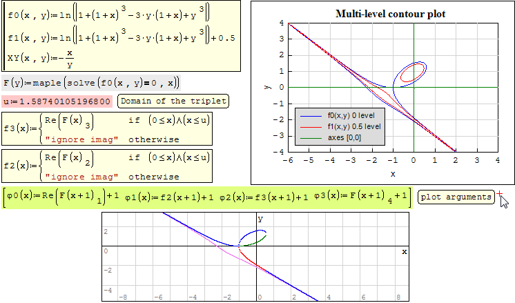

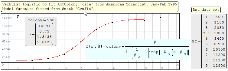

My friend, you will drop dead what Smath can do for you !
Further, Smath Community is very friendly and helpful.
Bad luck: PTC couldn't renew Maple contract. Smath/Maple companions
is the all thing for advanced Engineering/Scientific applications.
Smath is superb for publishing projects. In many respects, easier
to work with than Mathcad was [11 and earlier].

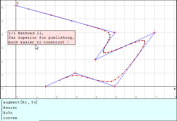

... Mathcad 11 can't do the very same, superb for publishing.

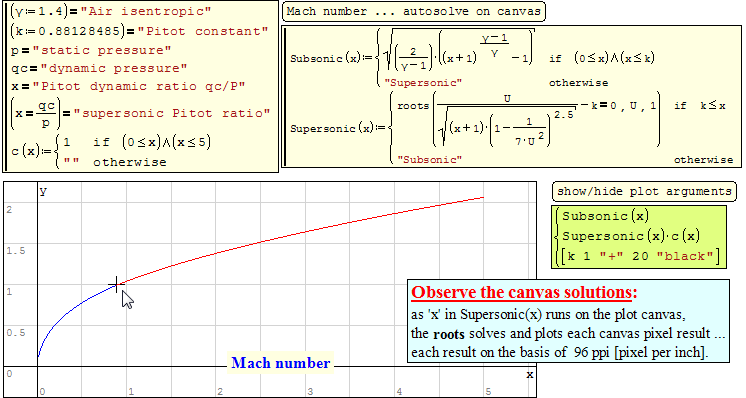

... from Smath/Maple companions
