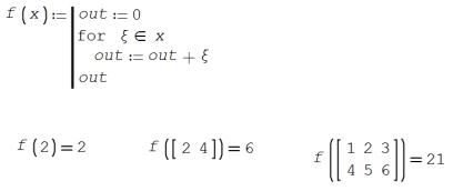

If not, you can try to modify the code with a loop for each element in the time1, like in this example:
frapuano 13.05.2020 13:56:00

More in there as cumulative.
Vector Cumulative.sm (24 КиБ) скачан 56 раз(а).
